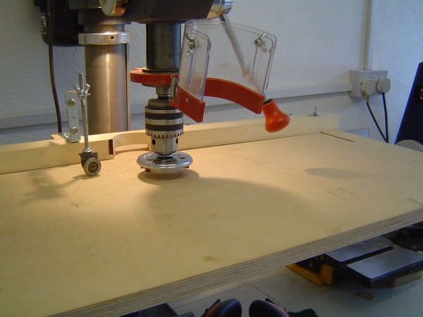

if you make a table and plan to do much sanding some form of dust collection is needed. some use a box type table as you suggest with replacable inserts to allow the use of different sized drums/drills. the inserts can be perfed to allow the downdraft.
i prefer to use a collection hood placed near the work.
either works and plans have been published in the various woodworking mags.
PostPosted: Mon Aug 14, 2006 8:10 pm
Make the table as large as you have space for. My table is 40"x20" (actually it's in metric!) but I also add a longer piece when thicknessing, or rather thinning, sides to give extra support. The down draft table is a good idea that I may have to steal.
For dust collection I use my swan neck funnel attached to my extractor, this is moved into place for whichever machine I'm using. One thing that I have found important is to have a cut-out on the fence to allow dust and chippings to be sucked from the table next to the planer.
PostPosted: Wed Aug 16, 2006 1:43 am
My setup is similar to Colin's above, I really like your idea about the box with down pull dusk control. I agree with Colin, the larger the better to work on. Keep us posted and if you come up with a working design, please share, I am always open to new ways to handle the dust in this process. I have the ported fence as well with my dust collection intake sitting just behind. This works OK, but still get alot of throw off.
